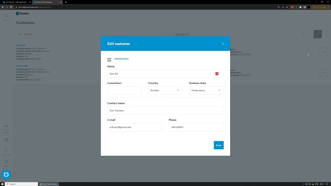

When you logon you will first see the Customer account screen.
If you only have access to one customer account, this one will be selected automatically.
If you have administrator access to the account you will be able to edit the account by clicking the pen.
Here you can change various contact / account information
Under the Administrators tab you can add and remove administrators from the account.
To add an administrator click on the field E-mail
Enter the E-mail then press Add
Click on the button Save to continue

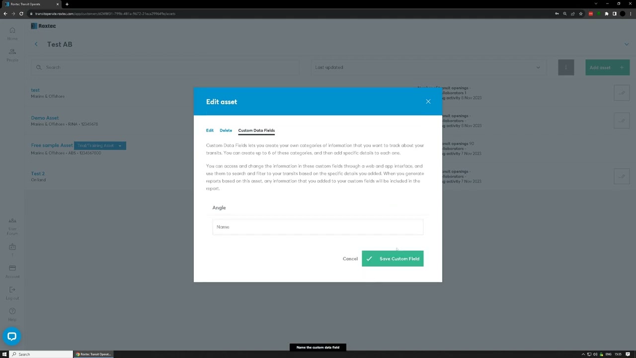

You can add Custom Data Fields
Click on the button Add Custom Field
Click on the input field Name
Name the custom data field
Click on the button Save Custom Field
Exit the dialogue to continue

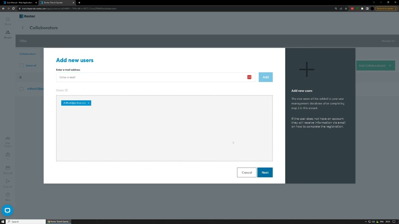

3 - Add collaborators
Video transcript
Add collaborators
Start by clicking on People
Click on the button Add Collaborator(s)
Click on the field Enter e-mail
Click on the button Next
Select an Asset from the drop down menu
If you are adding multiple users, you can use the select all button to add the access to all of them.
Click on the access you want to add
Click on the button Save when you are done
Click on the link Access log to see any changes made to the Access list
Here all Access changes are being tracked.

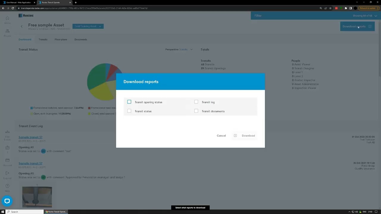

4 - The Dashboard
Video transcript
Dashboard
Here you can see a summary of Transit Statuses
You can change the Perspective from Transits to Openings
Click on Openings
Here you can see the Totals for Transits, People and Activity
The Transit Event Log displays all the most recent Transit events
You can Download reports
Select what reports to download
Click on the button Download
Click on the button Close

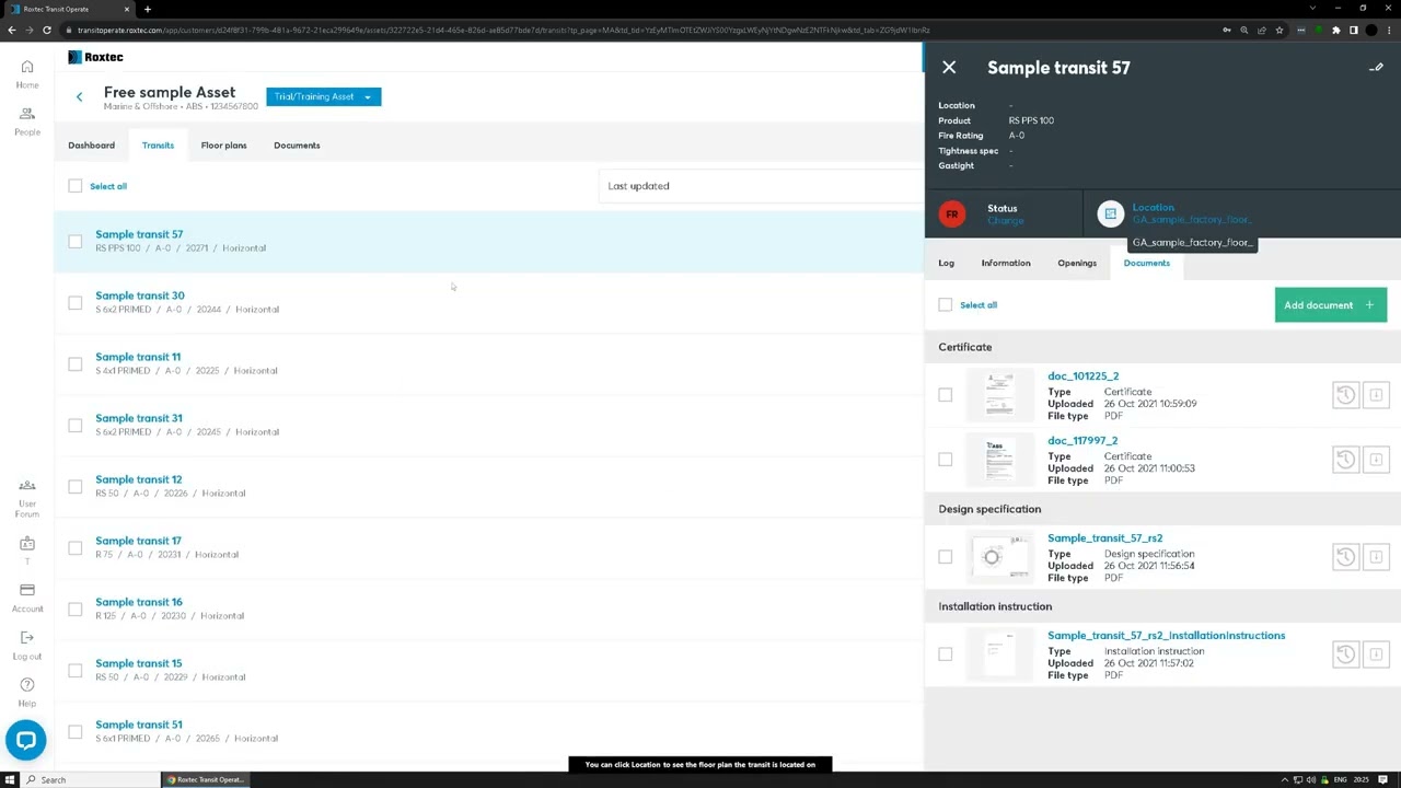

If you select a transit in the list, a detailed information window will appear
The Log contains detailed information about all changes made to the transit
Under the Information tab you will find various details and any custom data fields if they have been specified
The Openings tab displays the status of each individual opening
Documents contains all files that have been uploaded to the transit

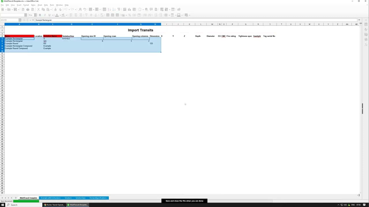

Download the Excel template
Save the file on your computer
Open the downloaded Excel file
Click on the Example with instructions
Here you will find detailed instructions on how to use the template.
For this tutorial, we will copy and use the example transits
Press and hold the Shift key down.
Click on .
Press CTRL+c.
Click on .
Click on .
Press CTRL+v.
Save and close the file when you are done

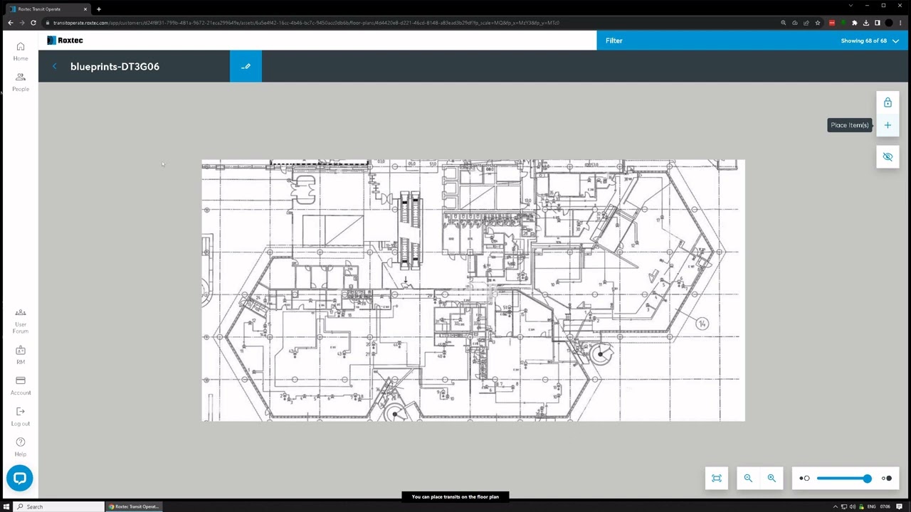

You can Add Floor Plans
PAUSE
Drag a file onto the field or click it to browse for a file
PAUSE
Select the file you want to upload
PAUSE
Click on the file field
PAUSE
You can rotate the floor plan
PAUSE

You can place transits on the floor plan
PAUSE
Drag and drop transits from the list
PAUSE
Release the left mouse button on the item
PAUSE

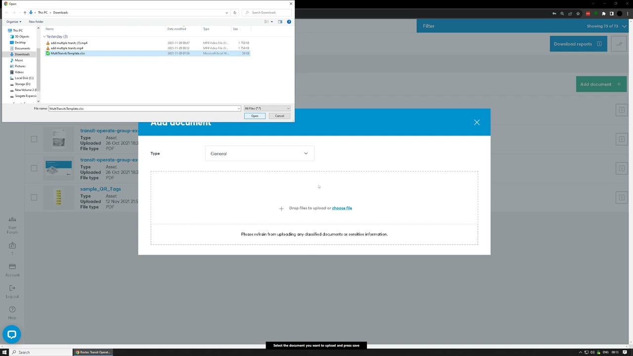

In the documents view, you can Add documents to the asset
Select the type of document you want to upload
Click on the item General in the list
Drag a file onto the field or click it to browse for one
Click on the item in the list
Select the document you want to upload and press save
Click on the button Save.
You may also press Alt+S.
